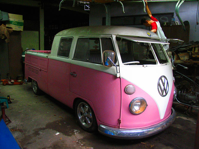

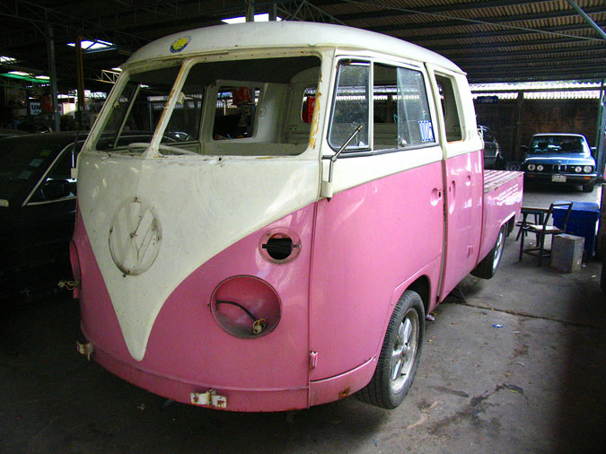

This is my brother's bus.
Th bus was sent to paint shop a year ago. Now it's not finish yet.

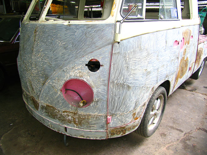

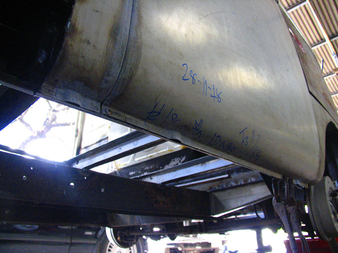

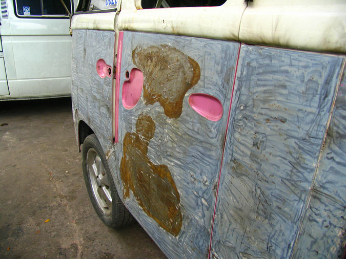

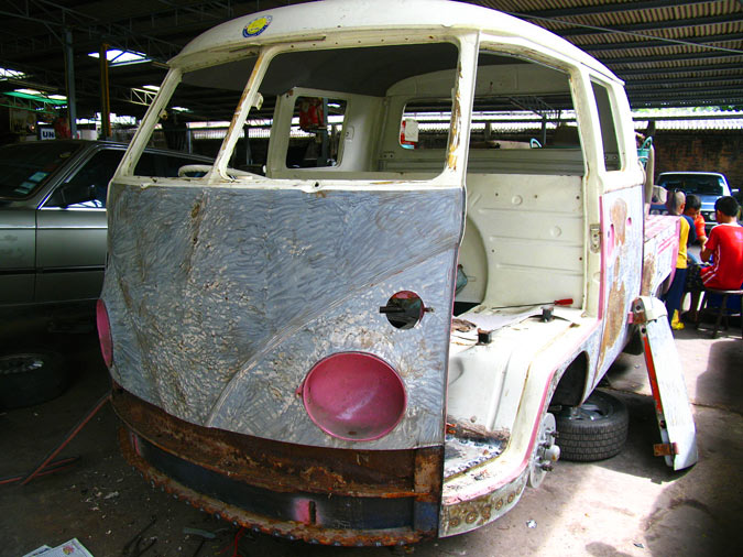

This DBC been in this garage for 2 years.
So it's time to sent to paint shop.
Then striping the paint to bare metal. I use gas and paint remove gel.

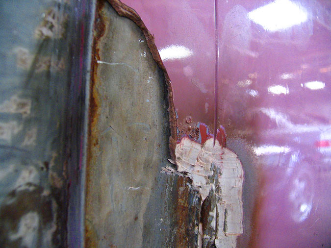

Reply with quote

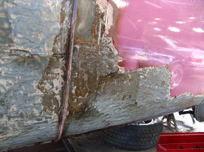

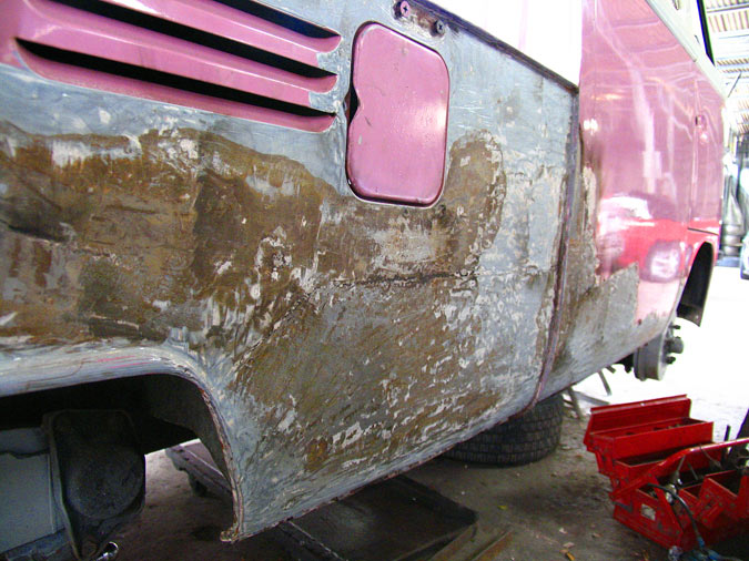

heavy bondo!
here too.

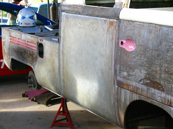

The cargo door is on the left with suicide style.
Suicide door for RHD Double cab is common.
Cut cut cut and cut.
Oh my god rust !!!

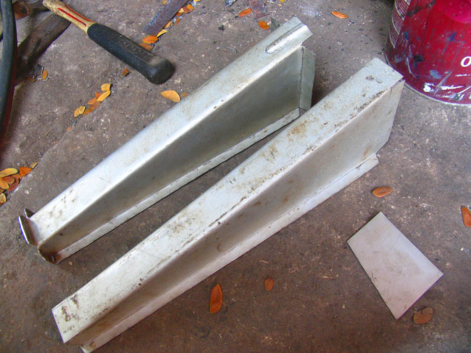

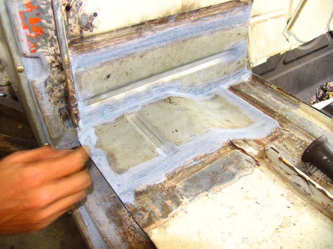

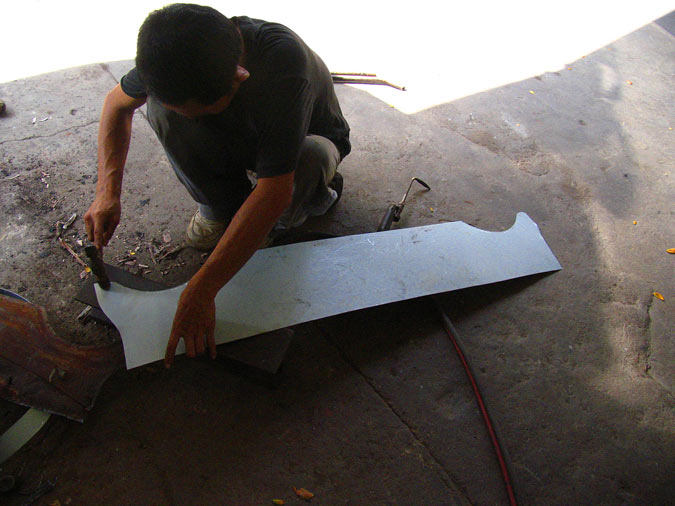

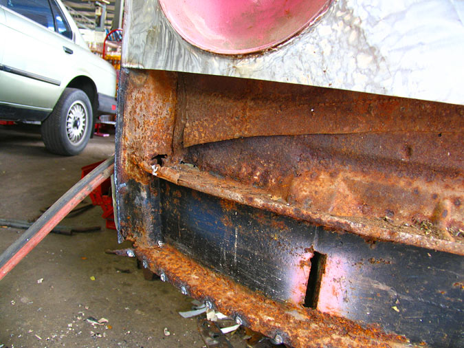

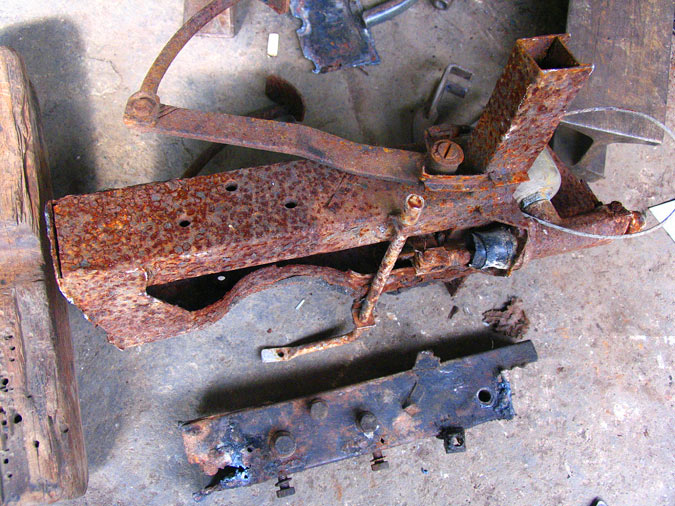

My front kick panel.
Very bad!
I decide to made it from sheet metal.
:-) this is result!
Thanks for my body man!

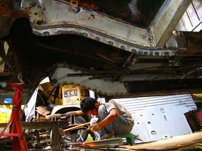

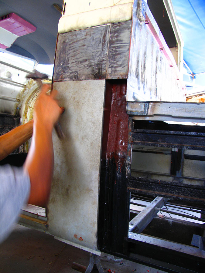

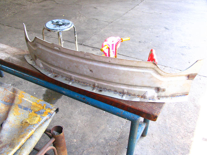

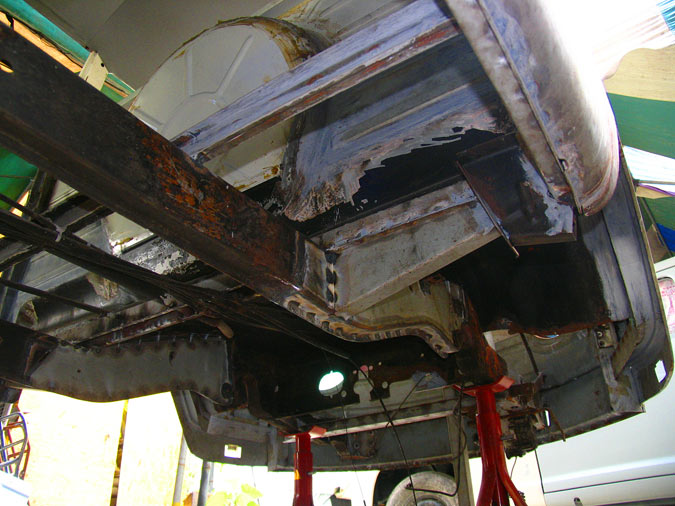

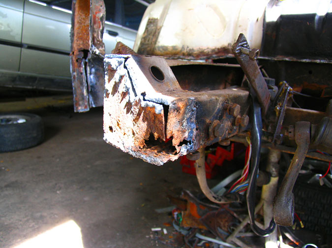

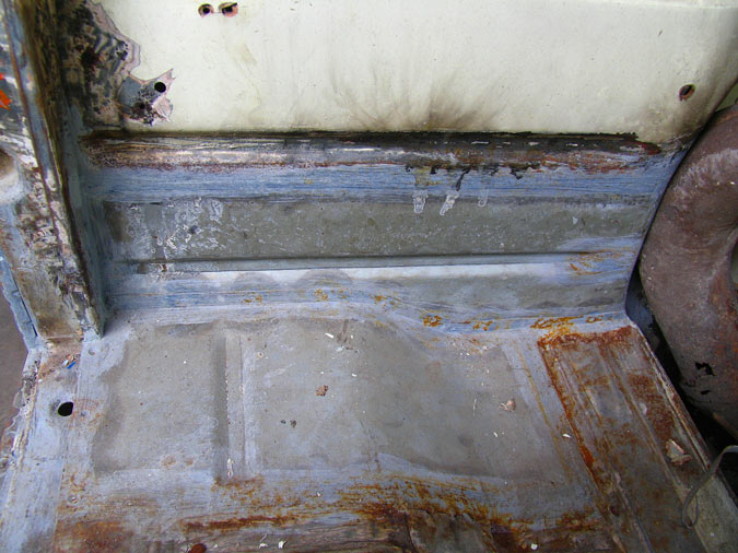

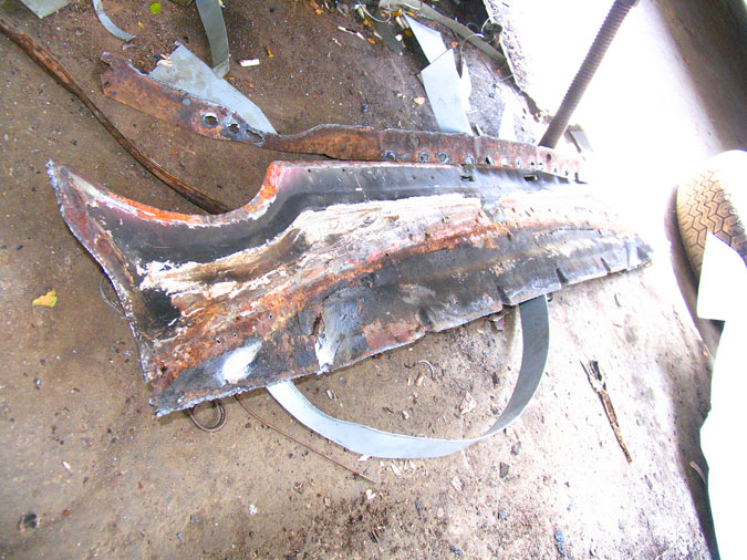

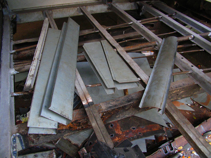

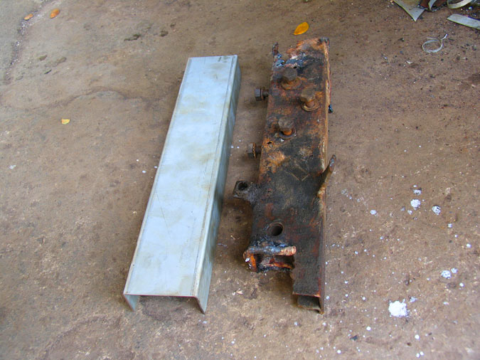

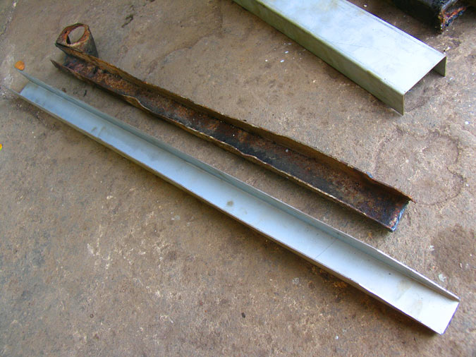

the more I cut deeply the more I found rust.
RUST is not a crime!
I got to made it again.
Such a rust bus!
every single part that rust in side. I made it new from sheet metal.

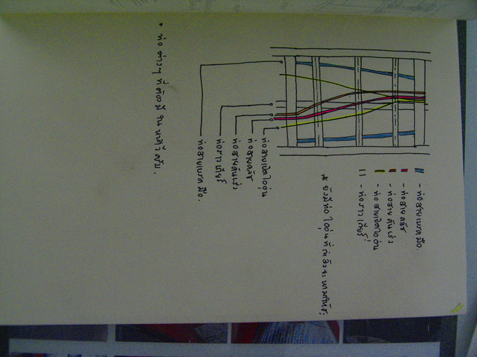

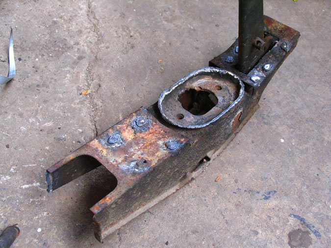

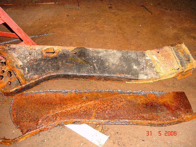

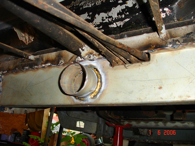

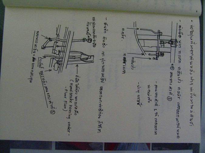

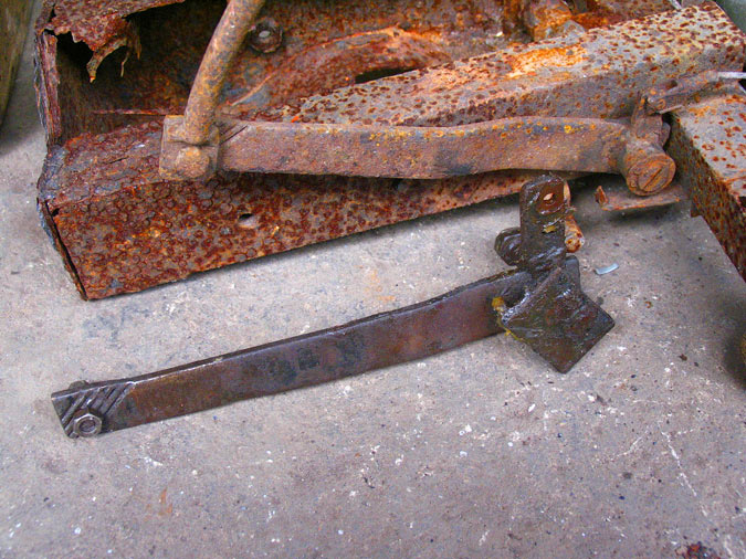

Before I decide to repro all the part I study them first.
This is what I learn.
pipe under floor plan.

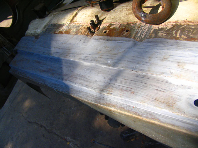

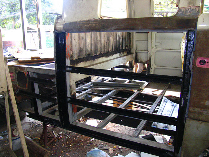

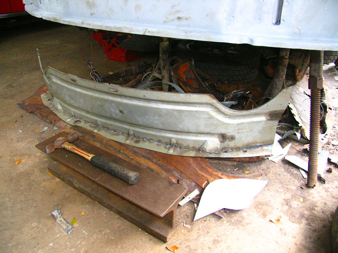

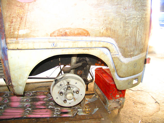

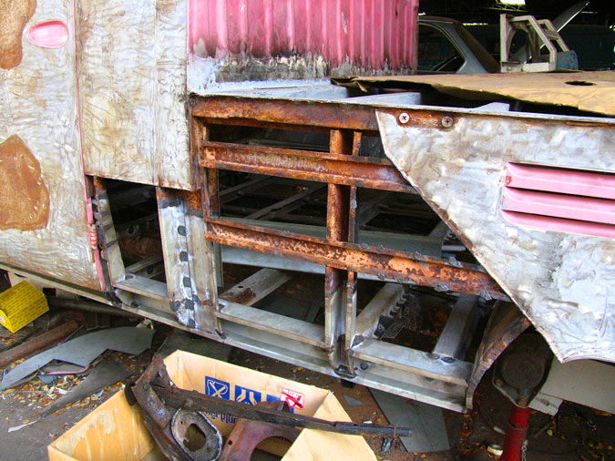

Yak! but it's work! This part I clean up and fit to its position.
Fit the front. The front of this splitty we call in Thai "Nar Vee"
thats mean V face.
The body work is going on.
Out trigger repro.
floor is gone

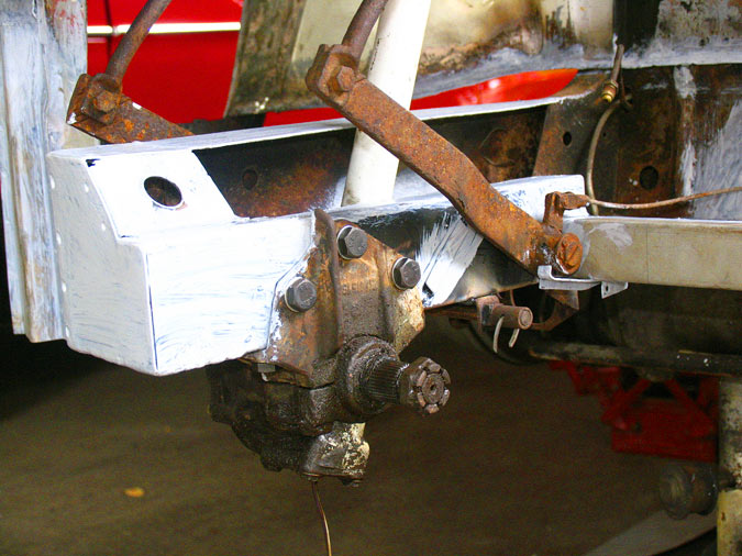

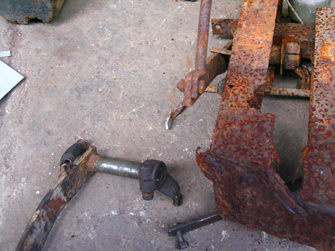

Fit it.
Chassis!!!
Don't worry Smile

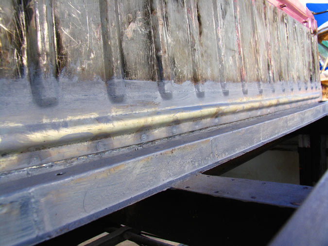

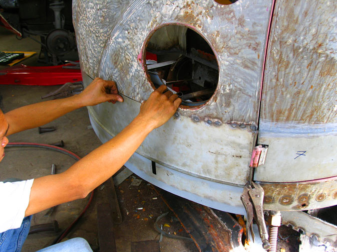

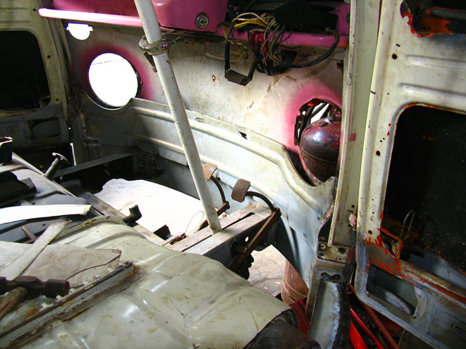

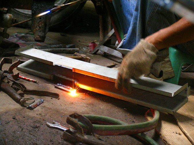

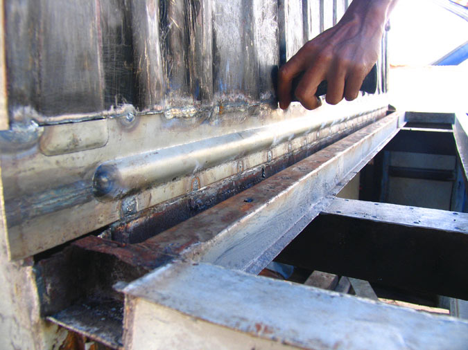

Start cutting body.
Clean up!
Welding
Then welding
Water vent is some what restorer forget!

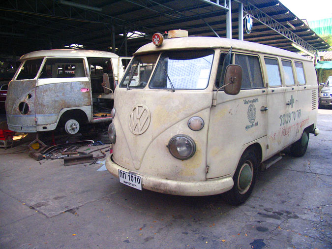

Krankenwagen has arrive!!!
It's my friend bus. Very mint RHD Ambulance bus.
I study most part from this bus... Thanks Mr.Tick.

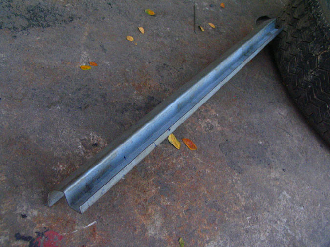

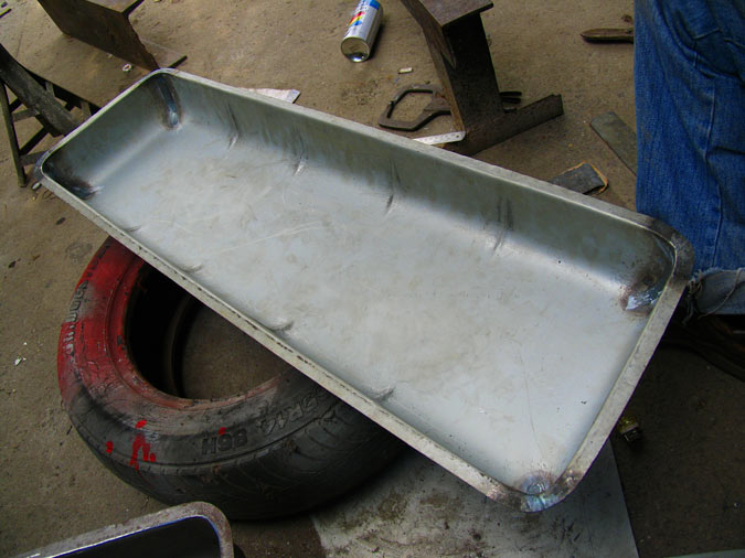

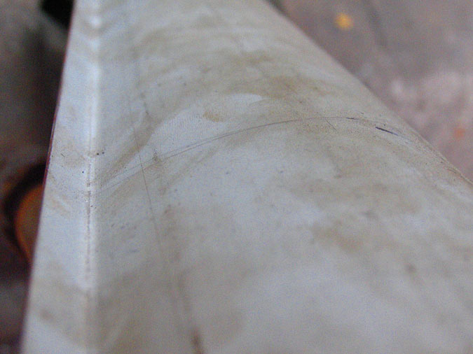

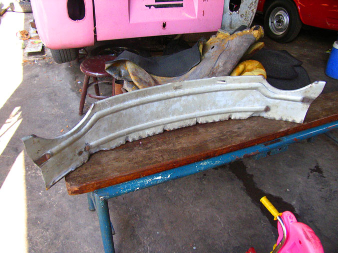

Smile new new repro.
Locker panel.

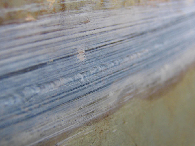

All the curve is original look like.
And all the welding is some what GREAT!

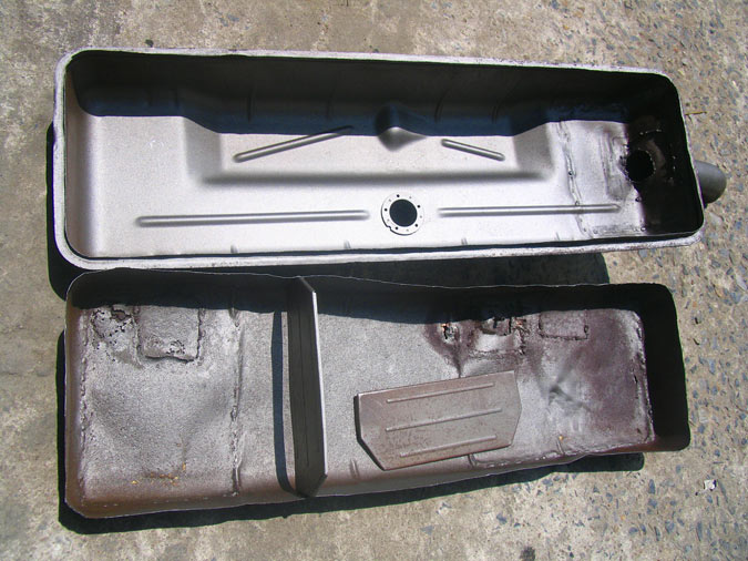

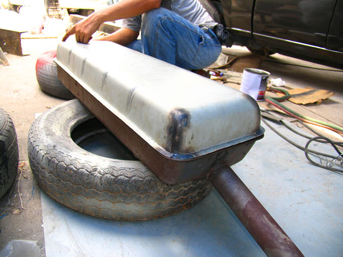

Gas tank after sand blast! Urrrr!!!!
Repro is answer!
99% look a like.

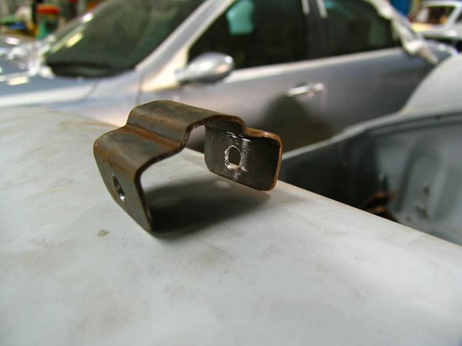

Bulk head.
Throught dog leg.
Safari hinge.
