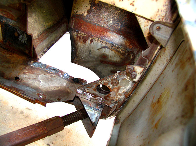

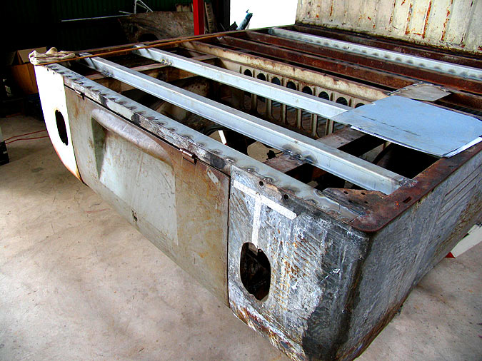

Now we do the trail.
That's too much rust.
I strip to bare by sand and paint with Wurth.
_________________
www.thaivwclub.com
 Back to top »

I fix this from this.
to this
_________________
www.thaivwclub.com

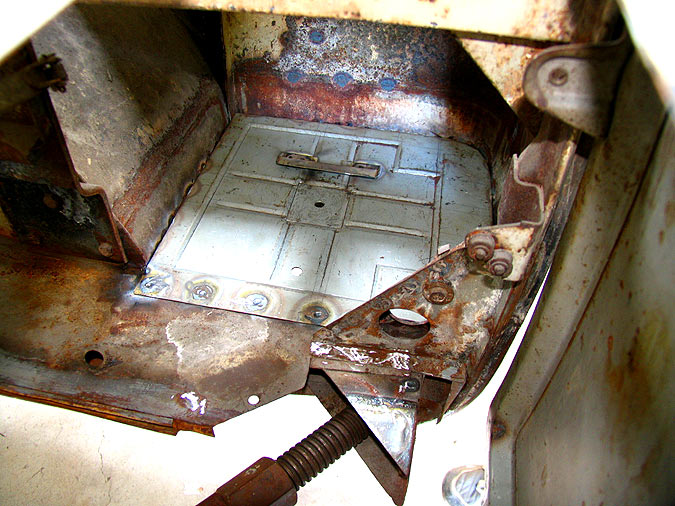

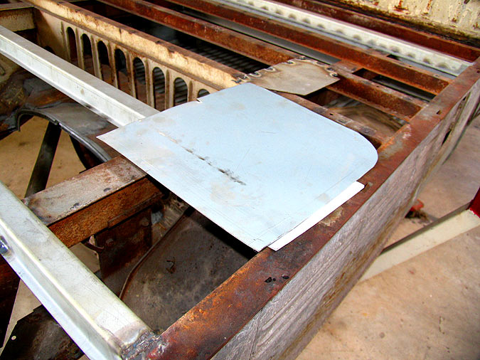

Almost finish the trail section.
Will do the battery tray...
The old one is not correct for 66 double cab.
See you next update.

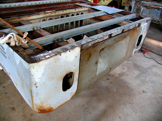

Finish the battery tray!!!
This pattern is correct for Double cab.
Rear apron.
C u next.

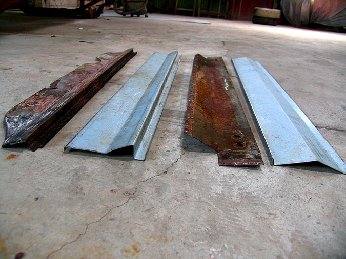

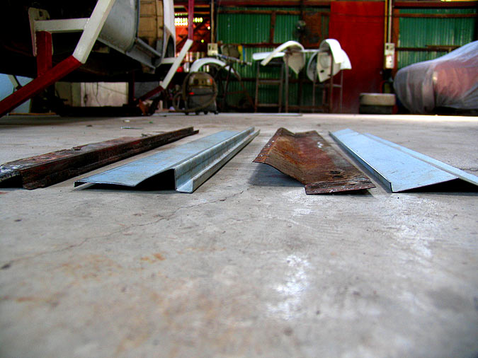

The result of rear apron!!!

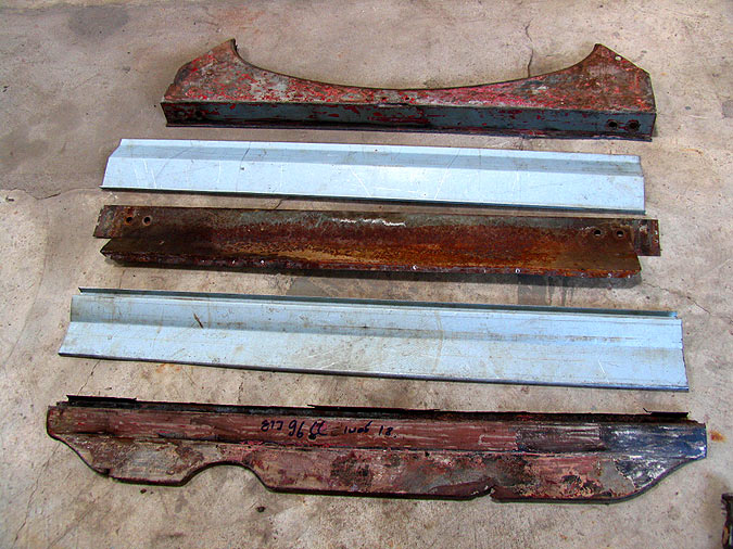

Rear decklid.
Umm rust foud! So what ... take it out Smile
